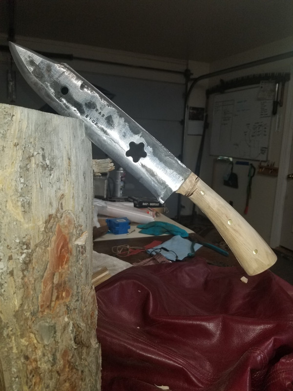

Forging knives have been on the shop work list for a while. Got my first one done.
It's a Bowie made from a mower blade. It's an ugly beast. I managed to get a good edge on it. This knife will passed off to a friend who camps about 100 days a year for testing and abuse.
Posts: 25437
“Forging” lol
That’s a hell of a lot better than I could do. But I love the star hole where the blade connects to the shaft.
The material really determined the design a lot. Because of the pre punched holes, the knife had to be big.
Mower blade steel isn't the best for knives, but good enough for learning. The handle is just hickory from an old pick axe, brass rod for pins, 5/32 diameter.
Based on color, the steel was heated to about 1500 degrees for quenching. I did no tempering due to the nature of steel. After cooled, I drop the blade several times on the concrete, and banged it on the anvil. It held up.
I learned a bunch, biggest take away is that I need to improve my grinding process a lot
